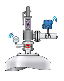

PRVs prevent overpressure conditions but, when actuated, may release hazardous pollutants into the nearby area. A plant must report these releases to the appropriate regulatory agency. If detection depends on a visible telltale signal, like a sock, that is inspected every eight hours, then the agency might assume the release lasted for eight hours. In contrast, an acoustic wireless transmitter (Figure 2) can provide 8-sec. update rates with long battery life, dramatically improving the timeliness of release reporting while also confirming the PRV has reseated and the release has stopped.
Safety and environmental bodies as well as insurance agencies often prompt compliance projects requiring more data from the field for monitoring purposes. In the case of PRVs, some environmental agencies no longer consider manual inspections acceptable and now mandate digital monitoring. After making a periodic inspection, an insurance underwriter may demand new monitoring points or secondary indication to mitigate risks related to asset health or worker exposure. In other cases, plantwide safety initiatives often require the automation of safety-related inspection rounds. Regardless of their source, compliance projects are mandatory, and wireless can dramatically reduce implementation cost and time.
Figure 2. Wireless acoustic monitoring device enables automatic remote monitoring.
In one application, an end user found the cost of wired PRV monitoring was $18,000/valve versus $3,000/valve with WirelessHART. Moreover, addition of the wired infrastructure only could take place during a turnaround whereas installation of wireless monitoring could occur during normal operations.
The project involved simply clamping a wireless acoustic monitoring device to the piping downstream of each PRV. All the devices were then joined to the WirelessHART gateway, which, in turn, was hardwired to the plant’s asset management system.
